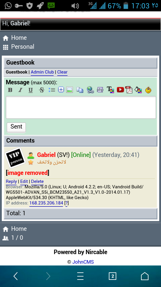

If images removed
CyberGhostNet Group

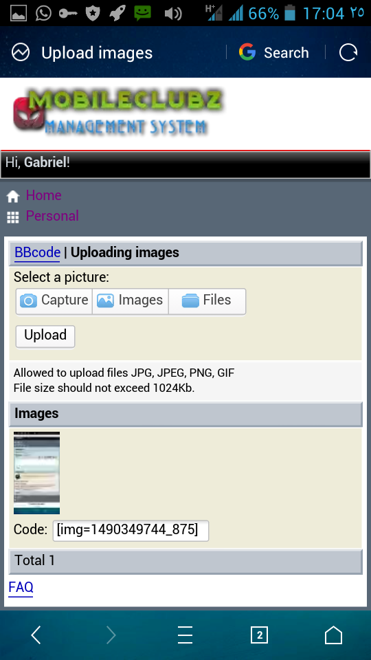

List of images
CyberGhostNet Group

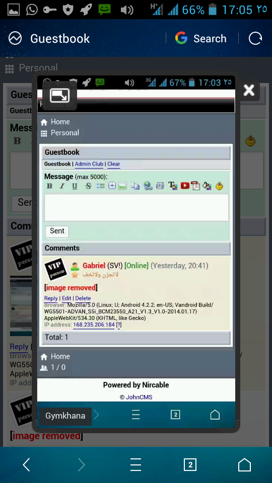

Sowed box
